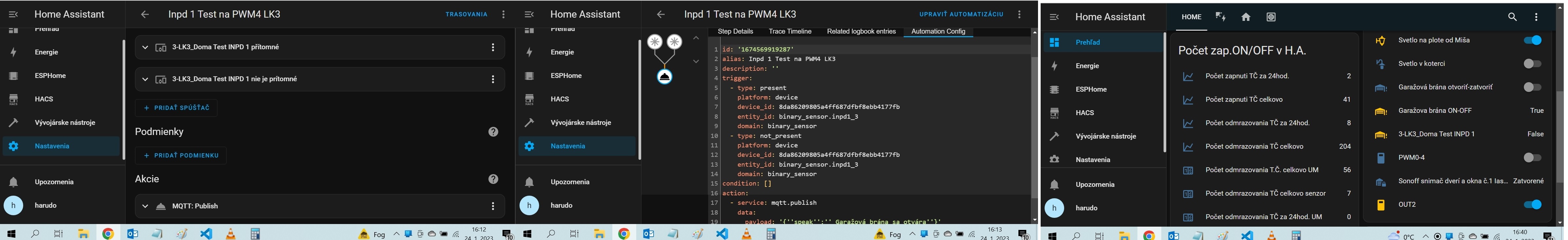

I want to ask, I have LK3 and on the Inpd1 input I have a sensor Inductive sensor SN04 N1, NPN NO also works in actions in orig. LK3 is switched on / off via the web setting, e.g. out2. But in the Home Assistant integration, it shows me in the on/off log, but it doesn't start the automation in HA, I have 3 pieces of LK3, the same thing happens. Simply changing the state of Inpd will not turn on any other device in the automation. Where is the problem? well thank you
And after changing the satv, both the icons are still lit at INPD.

Hello boss Cool . Is it possible in the next update (integration of LK to H.A.) to fix INDP1,2,3,4 when it is connected there e.g. open door sensor to work in Home Assistant in automation. (binary_sensor.inpd1). Because the sensor works ON/OFF but no automation is performed. Otherwise, the INDP icon does not light up either. Smile Thank you  Smile

I have add "state_class: total_increasingg" for energy entities (device_class: energy) so that the entity can be used in the energy panel in the home assistant.

(02-03-2023, 04:34 PM)hapi napisał(a): I have add "state_class: total_increasingg" for energy entities (device_class: energy) so that the entity can be used in the energy panel in the home assistant.
Hello, great, thank you, you will no longer need a custom for the energy panel. Smile  (Only the units still need to be modified in ymal and custom vid. code). But INPD1-4 i.e. the sensor in H.A (binary_sensor.inpd1) to work in Home Assistant still does not work for automation, it will be fixed in the next update. Thank you very much
homeassistant:
  unit_system: metric
  customize:
    sensor.energy1: # Spotreba studená voda v m3 do Energi panelu Spotreba vody
      unit_of_measurement: m³
      device_class: water
    sensor.energy2: # Spotreba teplá voda v m3 do Energi panelu Spotreba vody
      device_class: water
    sensor.energy3: # Spotreba Plynu - plynomer v m3
      device_class: gas
    sensor.power4: # Dovoz P4 činnej energie kWh tj. Spotreba Elektriky-FVE. Dat do Energi panelu do Spotreba zo siete
      unit_of_measurement: kWh
    sensor.power5: # Export P5 aktívnej energie kWh
    sensor.power6: # Celková P6 spotreba v kW Exp+Imp-Celková aktívna energia kWh
