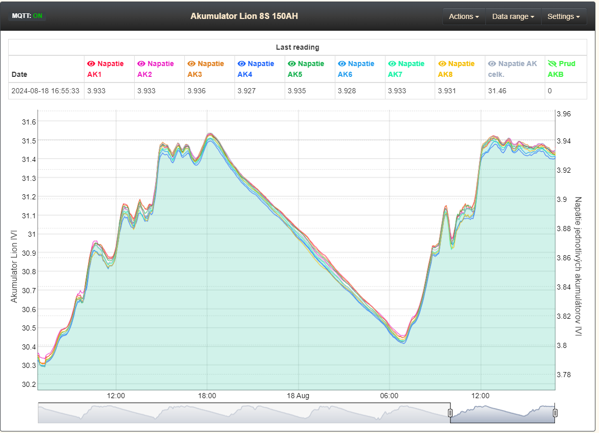

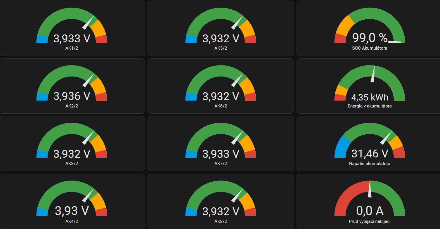

Anyone using data transfer from Li-ion BMS to LK3 via Modbus?
I have a problem with displaying the negative value of the current, it displays the positive value of the current correctly.

Thanks, I have these setting options in Modbus settings.
I have tried all of them setting and nothing works properly to display a negative current value.
