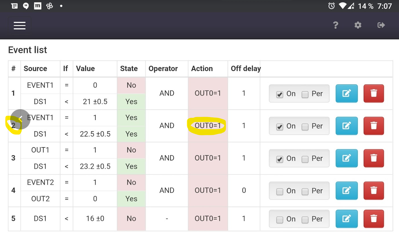

Hello, can you tell me where is problem? Event 2 from "Event list" wasn't applied on OUT=0. Why?
This phenomenon is repeated in different versions of the software. It occurs occasionally, sometimes once a month, sometimes 3 times a week.
HW LK v3,5
SW 1.32c
Attached is a photo from the web interface.
Thank you for any advice if I have something set up wrong.
LK2 - dead, upgrade to LK3,5 - temperature control of home, LK3,7 greenhouse control
Action state (out0=1) is the result of the last change in event list.
Probably event 2 (event1 = 1 and DS1 <22.5) was true when event 3( OUT1 = 1 and DS1 <23.2) changed state to false and off out0.
We will analyze and check this behavior
