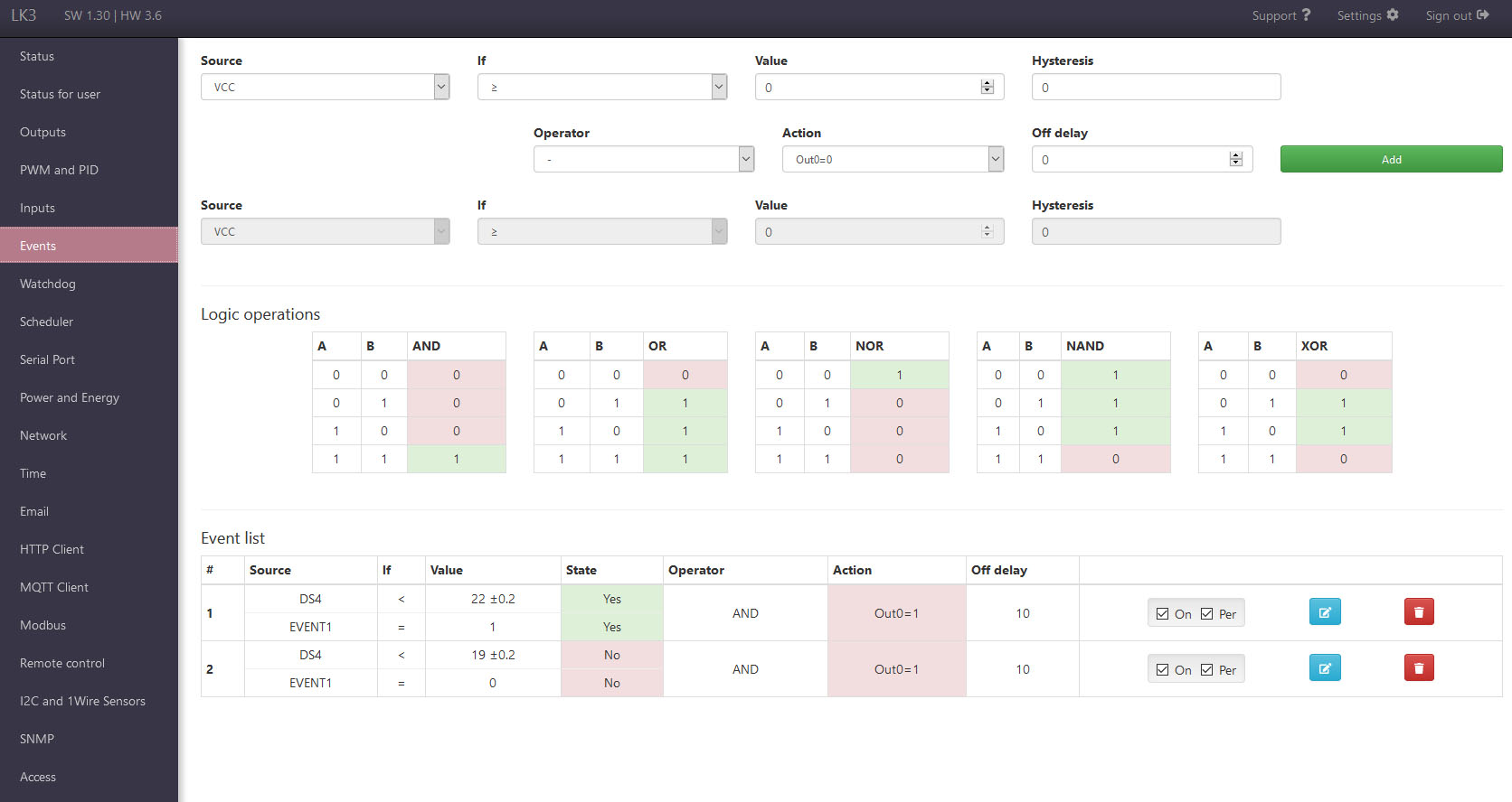

I have just noticed that Events do not work properly.
As can be seen in attached screenshot, Event 1 have both AND-ed conditions as 1 but output is still 0.
