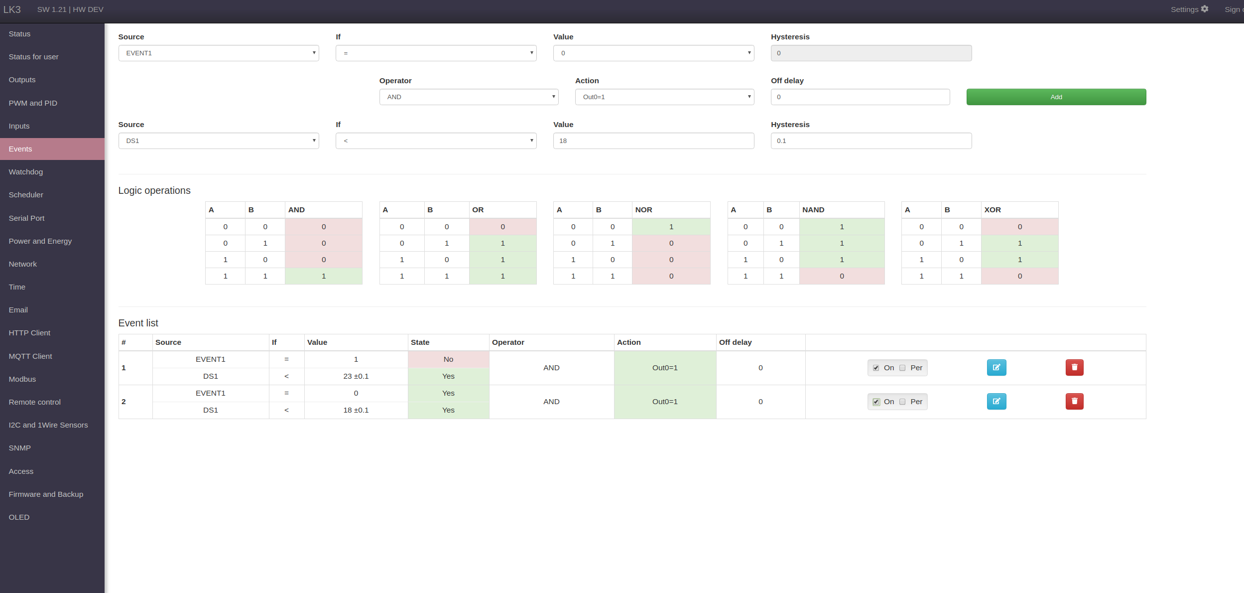

Request for Thermostat function and others - radunre - 09-24-2019 Hello, I'm a new to LanKontroller but really happy to work with. I have bought a LK3.6 and now study the possibility to use it as heating thermostat, for several rooms (4-5) but I think this function is not really possible using 1.11 FW. If there would be enough EVENT internal variables, the programming with current interface would be possible. For example (with current FW capability): - desired DAY temperature 23 degrees - desired NIGHT temperature 18 degrees - time window 08.00-22.00 (day temperature inside time window, night temperature outside time window) EVENT1 = 1 after time 08.00 (a time window option would help here) EVENT1 = 0 after time 22.00 EVENT2 = 1 if DS1 < 23 EVENT3 = 1 if DS1 < 18 EVENT4 = 1 if EV2 OR EV3 Out0 = 1 if EV1 AND EV4 Ideas for further FW development: 1. Is it possible to add a Thermostat function for 5-6 independent rooms/zones ? It should have minimum of - 2 time periods (heating / standby) - 2 desired temperatures (day / night) - Independent control of 5-6 zones with DS18 temperature sensors 2. On the Scheduler tab - Time window option (besides "One day" / "Select day") - Editable list, very useful 3. On the Event tab - Operator combination (in above example, the AND and OR functions could be in one line, sparing EVENT variables) - More EVENT variables, 16-24 pieces - Editable list, very useful RE: Request for Thermostat function and others - wilkxt - 02-07-2020 (09-24-2019, 12:25 PM)radunre napisał(a): Hello, I'm a new to LanKontroller but really happy to work with. You can do it simpler, see the attached pictures. In soft version 1.21 you can edit events and scheduler. |
